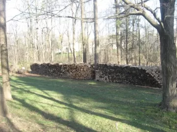

    Fattkidd the beer will be emptied lol. I did cut most of them down in size. Im leaving them eight inches in diamiter no bigger. I want some bigger splits to go with the bigger fire box. I have probably 8 cords of small stuff and medium stuff to go with it. Picture 018.jpg The stuff to the right behind the tree is big stuff the rest is small to medium, thats two rows deep also.

    Then you're in great shape. You've got a good mix and a ton of wood. It looks really good.
    I love the tire trick. Its a good way to split smaller stuff. I almost always have a tire around when I'm splitting wood.
