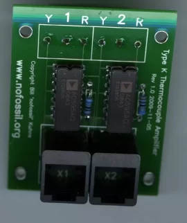

For those of you running controllers if you are getting the stack temperature what kind of sensor are you using to get it? I'm using the One Wire sensors with my Arduino controller but they can't read the high temps from the stack and would probably melt.

I just ordered a K type thermocouple and thermocouple amplifier to hook up to my Arduino.
I think you're pretty much limited to thermocouples. I use a stainless jacketed Type K probe style. Requires a thermocouple amplifier. Omega and others sell them....

I installed a K-type 1292F probe about a week ago ($15 +/- on ebay) and plugged it into my digital K-type thermometer -- the Arduino comes later. For the non-Arduino crowd, use a 9VDC transformer power supply and eliminate the battery from the thermometer, so it's "on" whenever the boiler is "on." The probe went in the same hole the old magnetic probe used; also re-used the circular magnet and pressure fit the probe through a small piece of sheet metal, then through the magnet with the sheet metal holding the probe to the magnet, and the magnet to the flue. The benefit, besides much greater accuracy, is quick response and feedback to boiler burn performance. The old magnetic probe was very slow in response.
