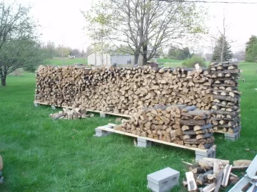

Here are a couple pictures of how I stack mine. Rows are 24' long with 36" between the rows. These are stacked in full sun, and stacked n/s for a west wind. I also have some stacked on pallets with 2 rows on each pallet leaving a 10" or so gap between rows for air flow.
  • [Hearth.com] Stacking wood

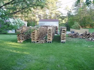

I am also a believer in not covering the wood pile that first summer. We do not cover until late fall or early winter; before snowfall. Here is what we cut last winter:
Bear in mind that this wood will not be burned for another six or seven years. It is 99% ash though so if it were needed, we could burn it easily by December.
Notice the stack is uncovered. It is still sitting there the same way as when the picture was taken.
