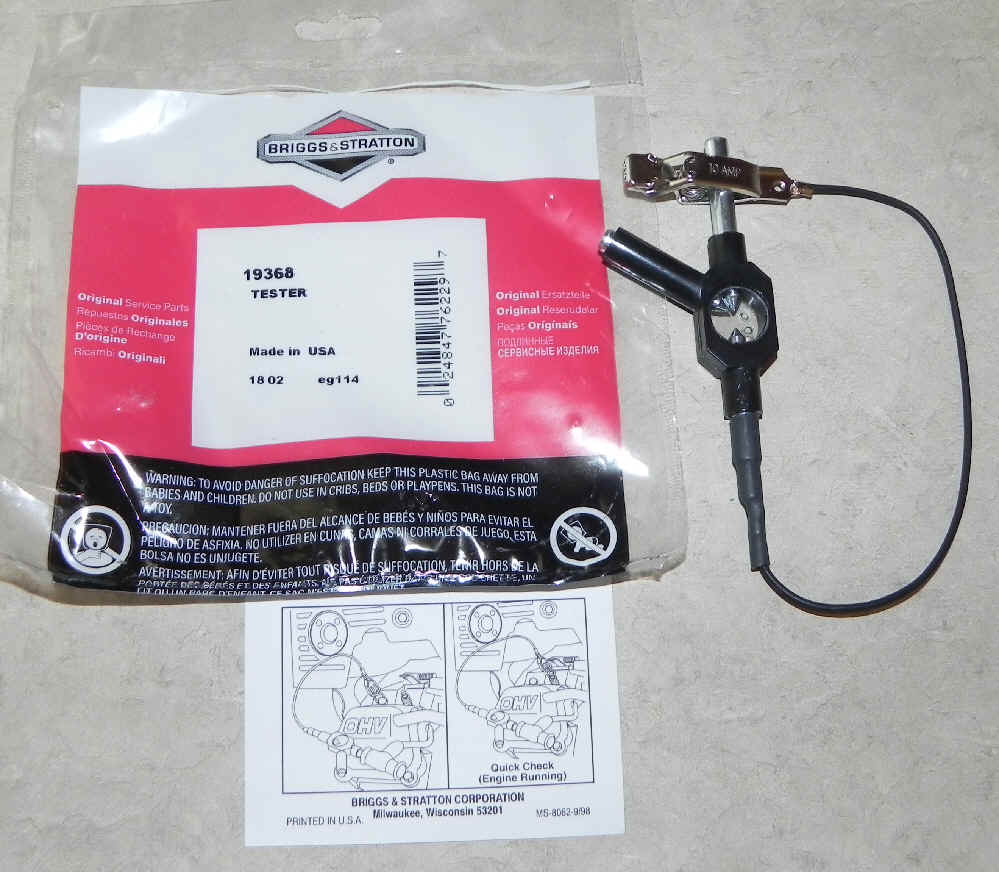

You wouldn't happen to have an air gap ignition tester would you? Would allow you to verify spark under compression.

Yeah, I wish I did, none of my neighbor gearheads do either. Best I could do was the old "open the gap way up" trick. If I can't ultimately get her going I'll take it in. The mega-fire ought to be here tomorrow, no deliveries today with the holiday.
