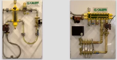

The hydro separators are often used as air elimination and some dirt separation. The vertical mounting works best for this. There is some engineering involved in the dimensions of those vertical styled separators.
I have used the Caleffi HydroLink mounted both ways and it accomplishes the separation fine in either position, but it is not as good as the vertical separators for air removal.
www.caleffi.us has some good reading and video on how separation works and the theory behind the design. You can also download a PDF of the Idronics issue related to separation. It's a technical journal moreso than and ad piece.
I've built a couple working cutaways to demonstrate the concept. Different food coloring added to the clear piping shows how well the separation works. in living color.

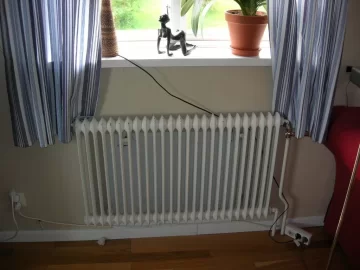

This is how the radiators look like.This is a small radiator.I got one under every window
The system is old.Build in the 1960.
The pipes are big.It was ordinary in that time to build the systems to work whitout pumps.
self circulation? i dont now the word in English.
The one on the picutre has smal pipes to it.The former owner to the house have change the pipes to the radiator to small ones.
I dont now why. :-(
When the outside temp is about 0 c the temp to the radiators is about 30-35c
You can se the temp in my graph.
The outside temp is the pink one.The temp to the radiators are the green one

Thanks Hannson, The self circulation is "gravity flow".
