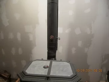

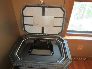

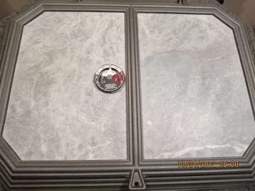

    I'd like to ask all the catalytic stove owners where they place their stove top thermometers for proper cat engagement? And where is the best place for your flue pipe thermometer? I have mine about 16" from the top of the flue collar. My main reason for asking about the location of the stove top thermometer is the fireview has a sheetmetal shield under the lid directly over the cat so I'm sure that's dropping the heat quite a bit.

    Mine is above the cat. And the flue therm is just slightly above the tee, reason being that any higher and it would be in the brick chimney. ;)
  3. charly
    charly
    Guest 2.
    According to my Fireview manual that I read today, that's where they want you to place the thermometer. I'm going to shoot my IR gun at the top once I get mine running to find the start up hot spot. The IR gun works well for that.

    Woodstock tells us that if we place the thermometer directly over the cat, we can work on the assumption that the interior stove temperature is twice the temperature being read on the stovetop.
    On the Fireview you can engage the cat with a stovetop temperature somewhere between 200 and 250.

    dylskee, you have it place correctly. This is exactly what Woodstock recommends.

    Okay, I did place it where the manual recommended but I was curious where others place them. I just figured it would be hotter if I didn't place it right over the cat shield.

    dylskee, I've usually got my stove top thermo in a similar spot but further back, off the heat shield. Seems to be a hot spot, but the thermo can vary depending on how the load is burning; Sometimes one side of the load will be hotter and the stove top on that side will be higher.
    My flue thermo lies on the horizontal tee snout, several inches behind the rear-vent flue exit. Not many options here, with the liner in the chimney. I've been thinking about drilling the tee for a probe...
