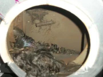

    clean exhaust in July before my roto cuff surgery put bag over vent cap wind rip bag bird got down then up in to blower. clean out made new gasket rtv let sit over night motor good amp reading normal made screen for vent cap good to go .thanks granger has motor for 44.00 fyi. old motor fine now bird jam it
