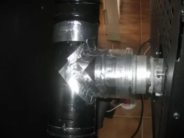

ya Im using the tape also, I forgot to mention that. the only problem is the 3way T doesn't tape up very well and has alot of seams that leak.

The T CAN be taped, as I show in the attached pic below....this is before spraying with satin Hi heat stove paint.

Yep, that is exactly how I taped my tee and the smoke smell quit. A cord wood burner is never gonna feel like he is getting the heat from a pellet stove like he got from the wood stove. I know, I am a cord wood guy. But the consistent heat and the room blower are what have me giving a pellet stove a shot. It won't have that up, then peak, then down curve like the wood stove. It will just sit there and keep cranking out the BTUs.
