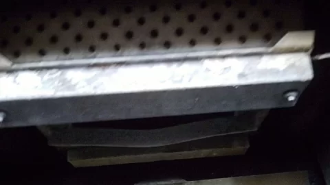

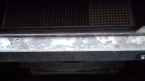

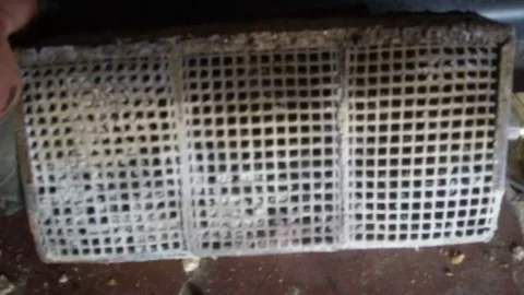

Swapped the cat out yesterday so that I can give the original a good cleaning. Pretty painless, pop the flame guard off, use a screwdriver around the edges to slide it out. Then, pop the new one in. It may have taken 10 minutes.

bogydave said:I hope to get 2 to 3 seasons from the ceramic one.

SolarAndWood said:I brush it a few times a season but have been experiencing lazy light offs this year. Thinking its time for a soak.

They've got the procedure laid out in the manual...SolarAndWood said:Scotty Overkill said:OK so whats the procedure for cleaning that CAT?
I'll leave that question to the experts as this will be the first time for me. My understanding is you have to be very careful with temperature and the solution you soak it in to protect the catalyst.
bogydave said:I'm curious how the ceramic holds up to your cleaning.
