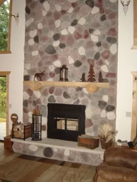

Anyway, I went to Wal-mart today looking for some fans on sale to move some heat around, hopefully getting some into the basement this winter. I got a pretty good score. I purchased 3 Lakewood 45" tower fans. They were normally $56, I got them from $21. Now, how do I use them?
My house is a ranch, with a large loft. The fireplace is on the south wall of the home, with high ceilings above. There is a ceiling fan above the fireplace, which I plan to utilize. There is also a ceiling fan in the loft which will get used. The basement door is just on the other side of the family room, about 15' from the fireplace. The stairs have a 90 halfway down. I'm uncertain if I should try to blow the cool air up the stairs, or warm air down? Any advice would be appreciated. I also picked up a $10 wireless indoor/outdoor thermometer. I plan on putting the outside sensor in my basement so I can easily monitor the temp down there.

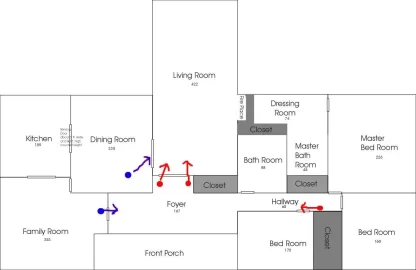

I have a ranch house and attached is a picture of where I place my fans. The three drawn in red are just where I like them and work great. The two in blue, aren't actually two fans. It's one fan that I have tried in two diferent places. I think it works best in the dining room, but I don't need it unless it's really cold out.
As far as heat down stairs, I can't help you there.
