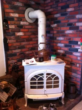

    If everything checks out, that's a very good price.
