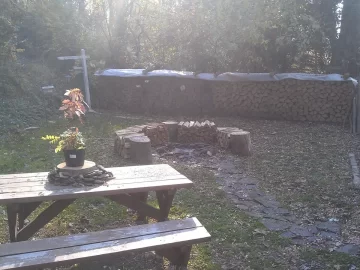

    I get cheap 6 mil rolls from Wal-Mart, leave the roll folded and top cover in rain or snow...they last...I cover a cord (24'x4'x16") with a piece 25'x10'...sunny in picture but was going to rain later...
