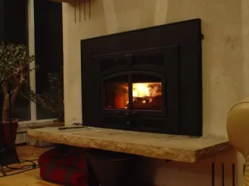

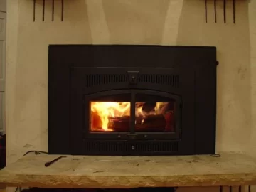

I am so thrilled with the way it has worked since then! Through the recent blizzards over the holidays and this week's windy cold snap, we have enjoyed smoke-free fires the way you're supposed to be able to with these new stoves. We have had zero problems since having this work done. It is so worth the money, I can't even put it into words. I've attached a couple pictures of the stove. We love the flush fit.

Hey Mike..Great looking stove! I just purchased the same a month ago and have enjoyed it from day 1. Glad to hear that its all ok for ya. Nice looking hearth there too...hmmm seems like we are forming a clique here to rival the Summit Crew, look out Roo, Hog...the heat is on....MSG great work!!!
Heya Mike, that is indeed a great lookin' stove. Too bad your first installer didn't know what he was doing, it amazes me how some people can charge good money for their ignorance. I knew from reading on this forum that anything less than a full flue liner was a bad idea but you should have heard the rant my installer went into when I asked him his opinion. Glad you got everything straightened out. Happy burning!

Mike, that is a great looking stove and room.
