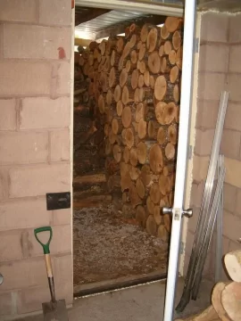

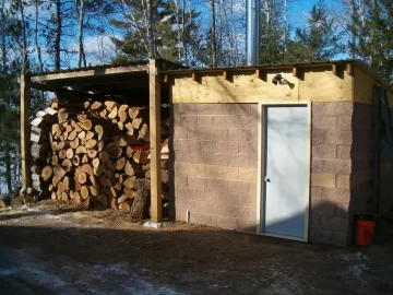

    I built a small 180 sq ft concrete block building on a cocrete slab for my Seton. Its about 30 feet from the house. I sleep better at night knowing my house is not in danger of burning down from something going haywire. I built a 14'X16' woodshed right next to the boiler building. I can simply go in one door, go over and open the other door and my wood is right there.

    hey patch , i like your set up.simular to mine. 12x 30 building 12x10 is boiler room.plenty of room for wood. i notice you use a small square nose shovel also.

    Hi Hen, thanks, yeah it works good. I made my boiler room big enough that I can store about 3 weeks worth of wood inside and still have plenty of room to move around. Got to finish the outside above the block this spring with some left over exterior cement board, paint the doors and trim and I'll be done. Just barely got it done in time last fall. I was still laying block in early November ! ? LOL
    I'm using the square nose shovel for the ashes. Thats the only thing I don't like about the Seton, gotta shovel out the ashes , but I only need to do that about every 2 weeks.

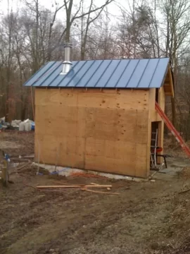

    I have my Paxo unit in a 12x16 outbuilding. We had a house fire in 1988 (from an electrical appliance fault) which totally destroyed the house. We were asleep at the time. Thank God no one was injured. We are VERY sensitive to the smell of smoke in the house! Our storage is in the basement (1000 gallons). If you are really good, you will never get smoke in the house. I am not really good, paricularly early in the learning curve. The smoke, bark, dirt, etc. mess is contained in my outbuilding. I have a 6-8 x 8-0 opening in one end so I can load pallets of wood in with my Bobcat. One advantage of the outbuilding is the chimney is shorter. Of course, that savings is more than offset by the insulated undrground pipe.
    And yes, that is a metal roof on my outbuilding. I have a lot of 8 foot panels due to an error by the contractor - his loss, my gain. The building will be sided with log siding. The house is made of cypress logs and the garage has log siding. I am going to add two shed porches - one on each side. One is for the Bobcat and the other will be enclosed for a chicken brooder heated in part by the extra coil in the Paxo boiler.
    If you put it in the basement, I would rcommend sealing the room VERY well - spray foam would be best, add a good exhaust fan (attic fan type), and keep a broom and shop-vac handy.
