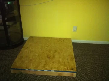

    Our platform has been built for the CAB50 by our contractors and it is made of wood on top of carpeting. The platform will be tiled down using ceramic tile. Is this safe?
    BTW, yes I am being a worry wart and will continue to do so for a VERRRRRRRRY long time. LOL. I've been screwed over too many times by multiple contractors since I'm the one talking to the them. I'm trying to lessen my hubby stress over home stuff.

    IMO, the hearth (platform) itself should not be sitting on carpeting....it should be right on the bare floor, or sub-floor. If the surface the stove actually sits on is ceramic tile, that part is fine.

    The stove will be sitting on the ceramic tile once the platform has been tiled.

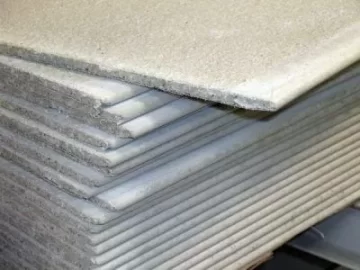

    I would lay down some cement board on top, before the tiles.
    hilbiliarkiboi likes this.

    Would that be a layer of cement?
  7. yooper81
    yooper81
    Member 2.
    Jan 17, 2012
    109
    10
    U.P Michigan
    backer board. several different types

    U.P Michigan
    usually sold in the 4' x 5' size range

    HotSprings NatlPark
    Tile installer should do it for a few(20-25)$. Strips cut for sides. Fasten w/screws.
    Flexibl.e bonding surface. Scratch it good with a utility knife, both sides with a straight board for guide, breaks easy.

    Southern MD
    My contractor just told me he's going to be putting down durarock sheets.
  17. CT-Mike
    CT-Mike
    Mar 22, 2008
    503
    88
    New England
    Durarock is a type of cement board, you should be good.
