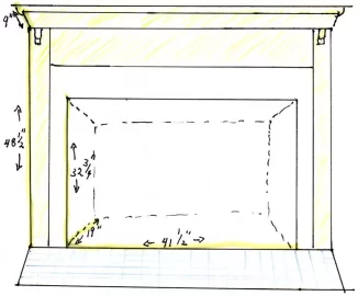

I want to put the wood stove partially into my existing fireplace extending five to eight inches into the living room -- see low tech specs and snapshot attached below...
My house is a 1700 square foot two story Cape Cod in SE Wisconsin – poorly insulated
Fireplace is centrally located in a smallish living room - 18x11.
I would like to get an overnight burn, but do now want to be cooked out of the living area. I had put a deposit down on a Jotul Castine, but when the dealer came to measure for the installation he informed me the mantle would have to go, and suggested the stove was too big. I am now rather befuddled and regrouping as the temperature and leaves outside begin to drop.
I had already geared up for extending the hearth and re facing the surround with soapstone, adding a ceiling fan as well as several floor and wall vents to move the heat to other rooms. – I would prefer not to loose the mantle entirely, as it quite suits the room -- but this is a COLD house.
I am looking for some thoughts and feedback from folks who have installed stoves as hearth heaters.

Hi Pamela, welcome and thanks for the drawing. You have several options. I have to disagree with the dealer, the Castine will not overheat the room or house. It is a pretty flexible burner. Can you tell us what the overall size of the house is and how open is the floorplan, especially as it connect with this room?
As far as the mantle goes, I would consider a removable heatshield attached with 1" spacers to the underside of the mantle itself. It could be painted white. This might be worth calling the stove company about to see if they would approve it as a solution.
Another option would be to install a nice insert with a heatshield at the stove. This would allow the mantle to stay intact. Jotul makes a nice mid-sized insert, the C450 that would look great in that spot.
