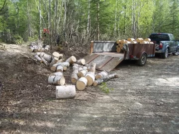

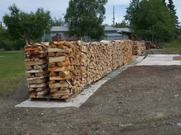

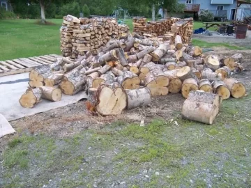

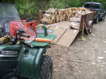

    Fell tree, limb & mark 17" lengths.
    Cut logs to the size I can skid out of the woods up the hill to the landing & cut rounds.
    Roll rounds down the bank to the trailer
    Load the trailer, leaving room for ht ATV.
    Offload the trailer at the splitting/stacking,seasoning area area, usually 2 loads of rounds.
    Split & throw into a pile
    Stack in 2 rows on pallets, & let it season until late fall.
    Clean up the mess & stare at the wood stacks a while. :)
    Eventually it will go into the wood shed for 2 years.
