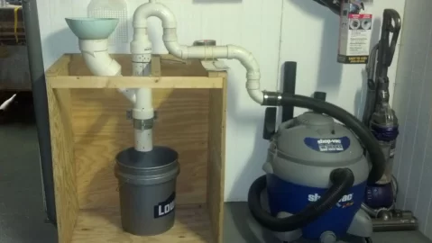

    This is the bottom of my shop vac after 8 bags of cheat river through my pellet vacuum sifter contraption thing. I would imagine after a ton of unsifted pellets your stove will swallow quite a bit of fines.

    You can clean the hopper on a bi-weekly to monthly basis. Or build one of these. (If you go back 3-4 pages, you will find several threads with MANY more pics) or just search pellet sifter. A search will come up with a parts list.

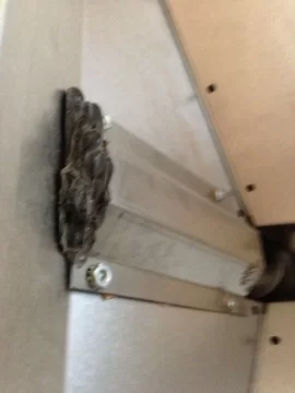

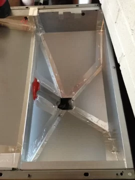

    I think I found the issue. Got up early this morning and pulled the stove out and removed the hopper cover. The first picture shows what it looked like when I opened it. There was a wad of RTV/silicone that was barely hanging on to the top of the auger cover. Underneath the silicone was the rope gasket that goes between the top of the cover and the chute where the pellets drop into the stove. One of the nuts that holds the cover on was holding on by a thread. You can see in the picture (sorry its blurry) that there were some pellet chunks stuck between the auger cover and the hopper. I pulled the cover off and I could see where I suspect the fines/dust were falling into the body of the stove. None of the hopper seams were sealed. They are riveted together and the seams were full of fines. I had a tube of high temp RTV left over from some work I'd done on the my toy (1969 AMC Javelin, hence my screen name) earlier this spring. I put the auger cover back on and sealed the top with RTV, then foil taped all the hopper seams. I then gave everything a good polish with some silicone spray I had in the garage. Hopefully this takes care of the issue.
    The bushing on the bottom of the auger looks fine. I'm fairly confident that the fines were getting into the body of the stove from the gap at the top where the silicone had come loose. I didn't pay that close of attention to it when I bought the stove last fall, but based on some of the other fit and finish items I found I'd guess it has been this way since I brought it home. I'll check it out after running a few bags through and see if this took care of it.
    Trips to the hardware store: 0
    Time to complete task: About 2 hours start to finish. I dropped a nut into the auger and had to fish it out.
    Cost of the foil tape and RTV I already had laying around: $2 or so
    Another season of watching the oil truck drive by my house: Priceless
    Thanks Dexter for pointing me in the right direction.

    Nice follow-up with the pics and great idea with foil-taping all the hopper seams, 343amc. What stove is this???

    That looks like the culprit. Not only will that prevent fine build up, but by sealing the hopper (much better than factory) you have eliminated lots of air infiltration points. Which will help with the overall burn (if it had a sealed hopper). Air is not your friend in a hopper, especially in the event of a burn back or hopper fire (God forbid, but staying Viligant keeps you safer).
    The pellets will probably feed better now also. As for polishing, I use Pledge Furniture Polish. Works great and smells great. Hell, I even use it on the exterior stove body. For that lovely shine :)
