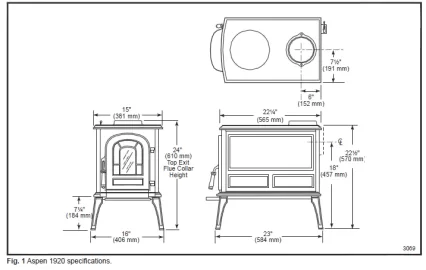

    I thought he had 27" height. The 602CB is 25.25" with the regular legs.
    In used, for your budget there is also the Vermont Castings Aspen which is a bit lower at around 24".

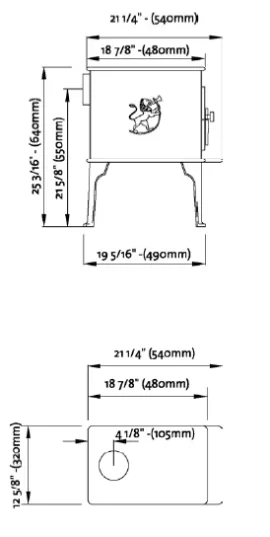

    Ya, the 118 is a much bigger stove. Here are the dimensions for the Jotul 602 and the VC Aspen.

    I checked out the 602.
    There are two used on ebay....VERY nice!! And not expensive at all. $550 WITH a glass door!! That is perfect!! Only problem is it's 4-6hrs away from me.
    But ok, at least I know there is an option with a glass front. How would this be installed? Would I need to insert a thimble/block/etc up into the chimney? It is a clay lined chimney. I'm just curious if I'd need to be able to get in there and move around or just put the collar on the stove and slide it into the pipe or something?
