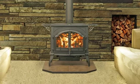

Lots of stoves to look at. The Isle Royale looks like the front runner! Thanks to all for the help!!
  • [Hearth.com] Top loading wood stoves
