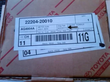

    Hi Nate
    Interesting, you said that because the P0171 code was all I got from the Auto Zone free check. However when I got desperate because it is close to inspection time, I paid the $94.00 for the Toyota Data check. Here is what they found:
    P0171 - Fuel Trim
    P0100 - Air Flow Meter
    P0110 - Air Flow Malfunction
    What makes me angry is that I paid about $75 dollars last year at AutoZone for a new MAF and it did not do anything but throw me down the wrong path of what to fix!!!!
    I could have done better at a Junk Yard!!
    Toyota says you must buy our $231.90 part or it May Not work!! So I bought it and installed. Let's see what happens!!
    Below are the pics of the Auto Zone MAF and the Toyota MAF and I see no difference, even the labs say Toyota!
    The last pic is the Old Auto Zone MAF the others are the new Toyota MAF

    Thanks, you guys. After replacing the AutoZone MAF with the OEM Toyota MAF Mass Air Flow Sensor or Meter as they call it, the car runs like a top! Much more pickup and the Check Engine Light is Finally OFF!!
    Hope this helps others! Thanks again for your comments. Maybe I will add some fuel injection cleaner also.....
