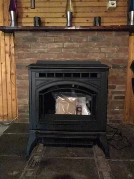

I can't wait. We had our old Franklin style wood stove removed the day before the Trekker arrived. We donated it to friends who had a smaller stove and were stoked (ha!) to get the upgrade to a much larger one. That Franklin was our primary source of heat and has been for years, so we've been walking around in sweaters and hats inside. I hope the tech can defeat the "error 3" with the new board and the stove will roar to life.
Eventually this house will be super warm and toasty, but this change over from wood to pellets hasn't been without its challenges, both scheduling and financial. I thought it would be a very simple swap but it hasn't been.
Here is where the Franklin was and the Trekker is.

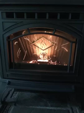

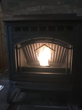

OK everybody. The tech arrived today and replaced the control board in the Trekker. It now works perfectly. So I can confirm that a new control board will resolve the error three situation. I will let it run for a week or so and then give a review of sorts here. What I can report now is that the Bluetooth key and thermostat paired automatically. I have the thermostat 18 feet away and it shows a solid connection. Thanks to all who responded.
  • [Hearth.com] Trekker error code 3
