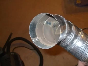

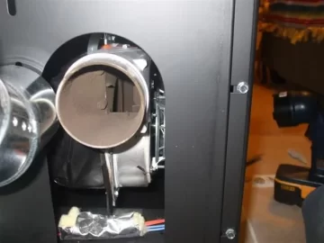

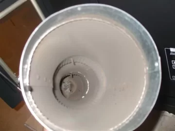

Check out the attached photos. They show my exhaust pipe and the back of the stove. Let me know what you guys think...does this look normal? I've only run about 8-10 bags through the stove.
-Chad

Is it an insert? If not why the single wall? If so where is the silicone?
Eric
Did you install the stove?
The Belfast Fire Department would be happy to inspect your install for you. If that is not pellet vent pipe you might be looking for trouble.
Somtimes my Quad will whistle and squeel when a pellet or clinker covers a hole in the burn pot.
Stove isn't an insert. I have it vented through an existing double walled metal bestos 6" wood stove chimney up through the roof. I ran single walled pipe up to the ceiling support box, double walled up through the attic and up to the roof. There was silicone on everything but I scraped it all off last night because one of my buddies put the silicone on and did a less than steller performance in that he had as much silicone on the side of the pipes and on the pad as he did in the spots it was actually suppose to be. My system has been inspected by my insurance company...all is a o k.
The fan and pipes look clean. You may just have some defective parts on your hands. Call Englander and have them listen if you can, and get some new parts for it. They're open until 7pm now, at least that's what I was told yesterday.
Good luck
