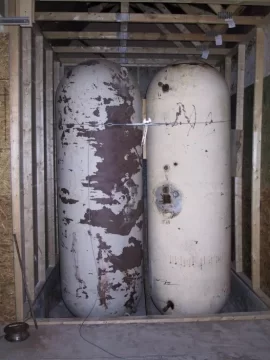

I have 4-500gal on end and like it.

I put my 500gal ones on end. I welded a semi rim on the bottem. They are in a 5ftx16ft addition on the side of my house. I insulated them with walkin freezer panels and cellulose. works great

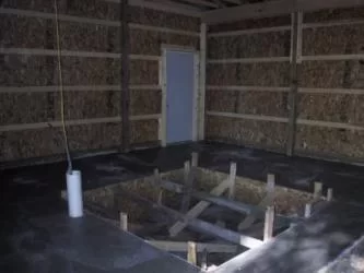

I stood mine upright on rims and made a "basement" to set them in. The basement floor is two feet deeper than the building floor and I had room to put 4' of insulation on top of them.
