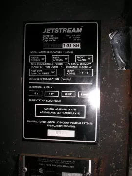

    First picture shows the CSA Tag and number and the type of fuel that the unit should burn and a further reference to the information on the name plate.
    Second picture gives minimum clearances with which the unit should have to operate safely and these are the minimum!
    In our part of the country, Insurances brokers have inspectors known as WETT inspectors and it is only these inspectors who are approved by the insurance broker to do an inspection of a wood burning appliance.
    These listed minimums clearances give the WETT inspectors a standard by which to determine that the unit has been installed safely.
    Farmer Tan has pointed out that their inspector had never heard of wood gasification and in this area that scenario is all too common. When we presented our insurance broker with the WETT inspector's report, it also included the picture of the boiler (posted below). She read through the report and then told me she still needed a picture of the wood burning stove; not understanding the red thing in the picture was the " Stove". The WETT inspector that did our inspection, had also never heard of wood gasification and was very surprised to find out that the technology had been around for close to thirty years. On his own time, he stayed and watched the unit burn for about three hours, and his conclusion was that these units present little if any fire hazard. When I meet him a month or so later, he was very surprised to find out our insurance underwriter still surcharged us to use this type of wood burner !
    In Canada, the CSA tag does not come cheap and to a small manufacturer, this can be huge.
    I have also attached a portion of the WETT inspector's report to highlite what the inspector is looking for in terms of approvals.
    I strive to meet and exceed these minimum standards, because if I do not and have a insurable loss, it comes back to all of us in higher premimums.
