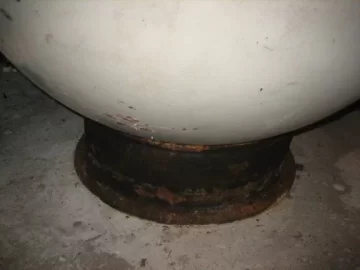

I was looking at that myself awhile back and wondering if a guy was to use like a truck rim for the stand and a little welding . If it was set exactly straight up and down I wouldn't see why it wouldn't work .
Here is a pic of the semi rim on the bottom of a tank.
