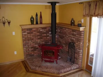

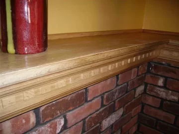

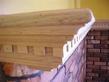

I just finished installing a new oak mantel with all the mouldings and trim on it.
I would like to coat it with a clear polyurethane coating for a natural wood finish.
I have a corner stove with the black pipe running up to the ceiling, and my "L" shaped mantel is about a foot behind it.
I do not wish the new oak to dry out and split from the heat so I was hoping for some suggestions on a good heat resistant clear urethane wood coating.

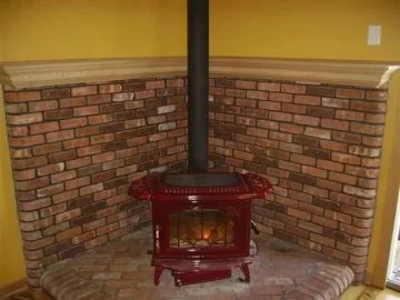

I ordered a pipe shield today just to be safe (see below) ...and to protect my new mantel
Back to my original post Q. - I guess I'll just stick with a regular laytex polyurethane, since the shield allows up to 6" min clearance

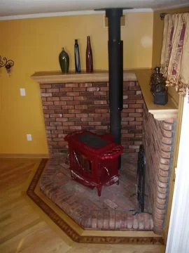

Sorry that I am dragging up this thread again, but I wanted to display the final product -
a urethaned mantel WITH NEW HEAT SHIELD.
(I know this thread turned into one about the shield rather then the topic, so I wanted to show both)

Great Job! Looks nice, and appears safe as well!
Gooserider
I ain't one for brick, even though thats what I'm stuck with for now. But that whole setup is one fine looking ensamble!
Nice mantle work, and the design in the floor man that is damn nice!!!!!
Very nice!!!!!! And safe as others have pointed out.
Two thumbs up to you.
Really nice Brian. I love the rounded brick hearth. The whole setup looks great. Congrats!
