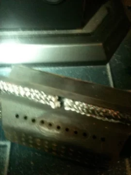

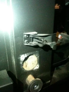

Have you cleaned the two openings on either side of the stove? (See pic). How is the burn pot gasket? I replace mine every year with a new length of 5/8" rope gasket. The original one had a gap where the ends met allowing an air bypass.
I also added self stick flat rope gasket to the flange near the door hinge and the flange near the door latches as both sides had sizeable air bypasses because of the way the door closes.
The last thing I did was to lay a length of 1/2" rope gasket in the airwash opening.
