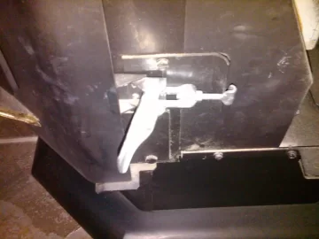

Below is a picture of a door hinge that has an adjustable nut on it to make the door gasket tight. If you do not have that then I suggest you go with a 5/8" gasket. I had a similar issue with a stove once. The manufacturer spec was for a 1/2" gasket and the original gasket was loose on the left side. When I replaced it with a graphite 1/2" gasket it was still loose on the left side. Now when you install the gasket it can be stretched out some or pushed back to make it thicker but that is hard to do. So if you have the time I would really appreciate you trying the 5/8" gasket and let us know how you make out.

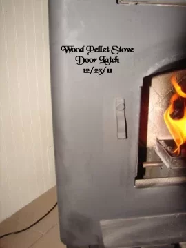

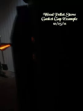

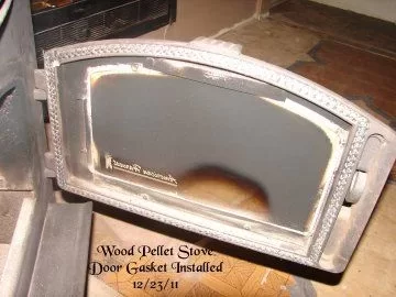

I'm trying to attach 3 pictures showing my gasket installation, an area that the gasket is not touching the door opening and of the door latch. I hope I made the pictures large enough for you to see them clearly.
When I close the door, there is NO TENSION when I lock down the lasp. There is no adjustment to the door tension available on this model. I'm going to try to tap the latch down like MSCJ did on his unit.
The gaps I tried to show in the picture are very small and they are spotted on the top right side of the door, the left side of the door around the latch area and I'm not sure about the bottom of the door because I just can't see there due to a plate that is mounted just under the door.
Now my question is this..........if I tap down on the latch, it should give me tension to close up the small gaps on the left of the door but will it have any effect on the top right side of the door???

You might want to take a straight edge an see if where the gasket hits against is straight.
I'd remove that latch, insert it in a vise and do my tapping that way. Do it slowly and test it.
In the upper portion above the door hinge (Is that where the small gap is?) it looks like that is a little frayed. On some stoves it has been known for the hinge pins to bend, have you checked them.

I have used a metal square and checked all sides of the door opening where the gasket meets the stove face. No gaps anywhere. So my stove is not warped.
The gasket wear you mentioned on the upper portion on hinge side is my cut of the gasket when I installed it last week. It isn't worn, just a frayed cut. I don't understand that happening because I used a new straight edge razor to do the cutting of the gasket.
The gasket I did remove last week was a one piece gasket. That surprised the heck out of me because everything I found for purchase was lengths of gasket, not a one piece unit.
Regarding tapping the latch plate............I was thinking about doing it while the unit was running and warm. I would think the latch plate would be more pliable?? Any thoughts?

I hate taping on metal when the stove is running, if you make a mistooke (well you now see mistakes happen ;-) ) best it not happen on a unit with a fire going if you get my drift.

I didn't make myself very clear on my tapping intentions. I meant I was trying to figure out if I could remove the latch plate while the stove was running and tapping the latch, then re-installing it to check out if I had a snug fit.
I'm in full agreement with what you posted. I would never try to beat/tap on the stove while running.
Sorry for not making my intentions clear. My mind was way head of my fingers..........once again.
