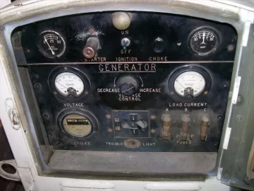

    The cycles will actually slightly increase (or decrease) as the voltage changes on most of these genny heads. It takes a pretty fancy unit to allow for the manual adjustment of the cycles. I gave away my dual wave form O-scope many moons ago.

    It takes "fancy" if you wish to adjust hertz independently from voltage. That was what I was trying to say above. The genny head on my seriously old unit could do that (1942). It no longer has the original genny head.
