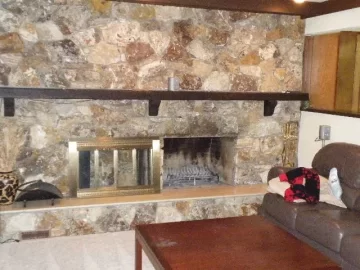

    Beauty, I will take a quick shot of my basement - maybe give you a better idea of what I am dealing with (give me 5 min).
  6. cowtown
    cowtown
    Member 2.
    Sep 10, 2011
    148
    0
    Alberta Canada
    Okay here is my basement - it is fairly large.
    One of the things that the installer told me I had to do was get the stone removed up to the gas assist control (right side of pic 3) - does this make sense? I guess they need to run a new gas line to the firebox.

    Man. That's gonna suck. No other way to punch into the firebox?
    What's on the opposite side of the wall to the right & how far away
    is the right side of the firebox from there?
    I've used 4 foot x 1-1/4 diameter masonry bits for jobs like that,
    mounted in a BIG hammer drill. Lotta bull work, & it beats the CRAP
    outta the guy doing it, but the finished product looks better than if
    you had to replace & re-mortar all that stone.

    To the right of the fire box and in the other room is a cupboard. The installer looked inside and said you couldn't come in from there and that the stone had to be removed. I had a mason come over to do some work on my fireplace upstairs (I am getting wood buring insert put in there). He didn't think it would be that hard, but also he didn't give me a price on it.
    I want to explore your idea a bit more - how can get to the gas without removing the stone, I don't follow you?

    If the cabinet in the other room can be removed, then a hole can be drilled thru the stone
    or the substrate material which is probably concrete block & thru the refractory brick in
    the firebox. I'm willing to bet the hole can be punched thru in an hour or less with the right
    set up.
    Another idea is to to come at the firebox from the rear. I don't know how much of the
    foundation is exposed above the fireplace location, but to dig down far enough to penetrate
    into the firebox, run the proper gas line for underground use, seal the hole to prevent
    water seepage, & refill the hole might also be an option.
    Anyway you look at it, it will be work, but I don't think I'd mess around with stone removal.
    I'd be leery of being able to replace the stone & make it look like it had never been removed...
    I guess it's your call...

    Interesting, you make some valid points - I will ask the installer if we could do it without removing the stone. I will let you know how it goes.
