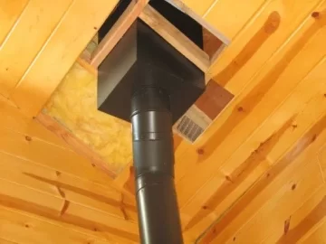

Installing a new wood stove. Need to go through a vaulted ceiling. Went with the Metalbestos ceiling support box (6T-SB), but after opening the box, found this piece to be a little "rough around the edges". (ie, gaps, rivots, no trim ring) What other options are there for going thru the vaulted ceiling? Looking at the Selkirk catalog I found a kit for this application, PCK (pitched ceiling support kit), would this provide a better looking finished product? Any other suggestions, ideas, photos, links etc. Thanks.
If you have Metalbestos pipe you are probably stuck with that ceiling support box as other pipe wont connect to it. I used Simpson Duravent and it worked fine for me and it has a trim ring. Heres a pic before the finished ceiling.

That Duravent box looks much better than this Metalbestos box. This box is rivoted, which provides for gaps at all seams, and, it has no trim ring. I just noticed that the MB catalog has, appearantly, another set of parts for use in vaulted ceiling app's., as mentioned above.
I'm hoping to find someone that has used this or knows where theres a pic of these parts installed (b4 I order).
The Simpsom Duravent box is riveted as well but is pretty clean. Keep in mind the 8" triple wall chimney pipe is 2 " from the side of this box and more from the corners. Clearance to class a triple is only 2"
