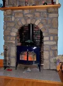

    I have a 2550, I get 8 to 10 hours burns.

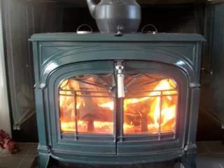

    So we spent the night at the inlaws last night and the Encore was going. I have been waiting almost a year to see that thing burn and it did not disappoint. I wish it could have been at my house, but this is as close of a second as possible. I have visitation rights! I got to feed it and play with it like it was a new baby! I really miss burning wood and it was a pleasure playing with this stove. It heated the house with no problem and looked so good doing it. For those of you who were waiting for a picture of the midnight blue encore in its new setting here it is:
