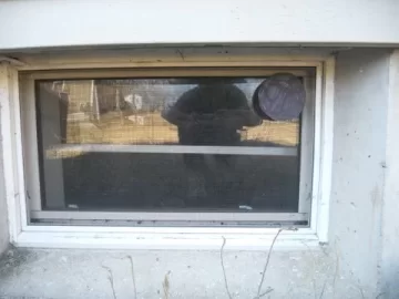

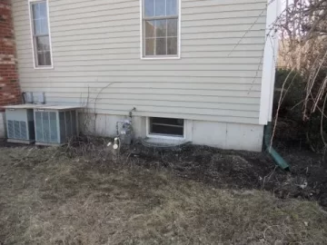

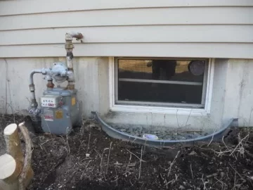

    if you look in the top right corner of the window there is a black 4" circle.this is where i plan to come out and i am pretty sure i will meet all clearances.this woul be without using a thimble.if i do use a thimble it will obviously lower my pipe.this set up has me at 37" from center of gas meter to center of vent.according to enviro meridian manual,clearance is 36"

    If you add a 45° after exiting window??? You will gain quite a few inches.
    I only say this, because 37" to center, means your closer than 36" to the actual meter.
    A 45° will gain you valuable clearance. And it you angle it up on a 45° , you will be moving away from the meter and also gaining clearance off the ground.

    This can be done, but after exiting the window make sure you have the required clearances from the meter. Might have to go a little horizontal to the corner (towards downspout) looks like you have your minimum 18" rise. use the simpson directional horizontal term not the hood. You do not need a thru the wall thimbble.
