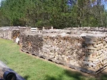

  17. timusp40
    timusp40
    Feeling the Heat 2.
    Feb 3, 2010
    266
    198
    Lake Orion, Michigan
    Red Oak,
    I'm sure that you will get great results with that walnut once it is ready. I sure hope so, because the stack in this picture is 1/2 walnut that was CSS last Thanksgiving.
    Take care,
  18. rideau
    rideau
    Jan 12, 2012
    2,169
    817
    southern ontario
    These stacks are so beautiful they look as if they've been painted.

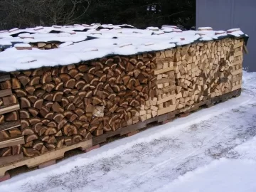

  19. coltfever
    coltfever
    Burning Hunk 2.
    Jan 4, 2011
    143
    32
    Middle Tennessee
    Who hit the stacked walnut with a snowball ?
    Backwoods Savage likes this.
  20. timusp40
    timusp40
    Feeling the Heat 2.
    Feb 3, 2010
    266
    198
    Rideau,
    Yeah, I catch a lot of flank about being fussy about the stacks, but what the heck, I love doing the work. Thought you might want to see the same stack 10 months later. Here it is.
    Take care,
    Tim

  22. rideau
    rideau
    Jan 12, 2012
    2,169
    817
    southern ontario
    Come visit anytime you like. I can keep you entertained . All joking aside, those are IMPRESSIVE stacks. How many cords do you have there?

  24. timusp40
    timusp40
    Feeling the Heat 2.
    Feb 3, 2010
    266
    198
    Rideau,
    Aprox. 9 cord. All hand split and all scrounged from tree services around here. When it gets to be too much for me, I might look at a hydraulic splitter, but not now, I'm only 66 years young. And by the way, no stove yet!
    Take care,
    Tim
