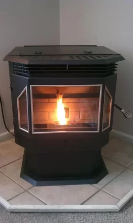

j-takeman said:
Looks sharp! First impression's? We'd love to hear them.
Surge suppressor? Don't see one in the picture and just reminding tis all. ;-)
Enjoy!
Come Jay...I'm not a rook
Of course I have a surge suppressor! lololol It's a Cyberpower surge, I actually replaced my old one with this one over X-Mas....it was sort of a present to my stove...lol OK....first impressions:
1 - I love the look of the stove
2 - Got a great deal from AM/FM
3 - It's way quieter than my pdvc
4 - I needed to crank up my LFF to 5 from the default of 1 to get good heat out of this thing......current setting is 5-4-1.....I'm currently burning a leftover bag of Greenways from last year....my pdvc loved them and the 55 seems to like it too.....house it currently at 75 degrees......
5 - I sanded the inside of the hopper....It had a lot of over spray that kept the pellets from sliding freely....I think another poster mentioned this too.
6 - So far the only thing I didn't like so far is there are sharp edges on the inside lip of the hopper...I cut myself a few times until I sanded them and knocked the edge off.
I burned this thing out in the garage for a couple days to cure that paint and get the smell out of the stove.....I'll post more if I think of anything....
