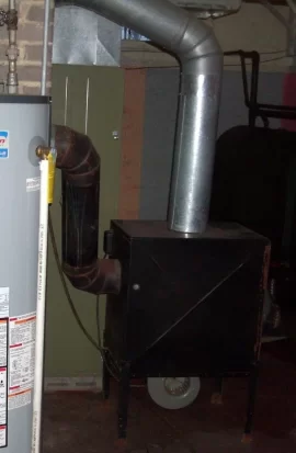

What are your thoughts on this basement woodburner?
Harmaniac
Nov 22, 2008
19
Southeast MN
We might be buying this house in two months and along with it comes this wood stove.......so take a look and tell me what you all think of it.......safety?.....model/make of stove?.....BTU's....etc.
Thanks,
Harmaniac
  • [Hearth.com] What are your thoughts on this basement woodburner?
Can't tell much from the picture, other than it looks pretty old and doesn't look like a wood stove. Top flue pipe looks like galvanized pipe, which isn't used on wood stoves. Also, the side panel has diagonal crimping, which is typically used to stiffen light gauge metal like is used in heating/ventilation ducts. Maybe the picture is just deceptive? Is that other pipe in back actually the flue pipe, or does that go to a boiler hidden back there?
A side note: Judging by the rust on the stove's feet, it looks like the basement has moisture issues. For your own peace of mind, ask the seller how much and how often the basement gets standing water.

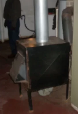

Elmoleaf-thanks. The black back pipe is the flue going to the chimney. The top flue I believe is a galvanized steel pipe. Is that bad in the world of woodburning? Every house in a 30 mile radius of this one had water in their basements August of 2007....SE Minnesota got 14-18 inches of rain in a 24 hour period. I'm assuming the rust may have come from that episode. Here is another picture.

Looks like a wood fired hot air heater... blower fan in the bottom pushes air around the firebox and the duct carries it upstairs... unique. Might not be a brand name attached to it somewhere? Scratch built?
Ask them how it works, how long it's been there... try it easy and see how it works?
I think you are right. Seems to me that someone posted info and maybe posted a picture about this stove awhile back. I had never seen one, but in the local area they were common.
I'd wanna make sure the fire box was sealed - no gases leaking into the surrounding jacket where the blower moves hot air. I'd have a CO detector right where the galv pipe exits upstairs.
That's what it is. Just spend a weekend up north and they were using one to heat their garage. Different model though with the blower on the back.
