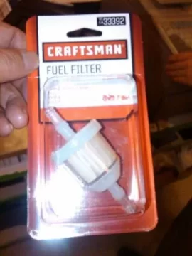

    Also my wife could smell a possible gas leak so I replaced the 10 year old gas line with brand new 1/4" gas line from the auto parts stores. The old gas line was stiff and stretched. The new line was more pliable and felt more rubbery! While I was ad it I got a new gas filter. I was absolutely shocked when I saw the Sears gas filter replacement for $9.99 !! I almost felt the barrel of a gun to help hand over that much money!!!! LOL Absolutely Ludacris!! Not only that they had improved these filters by making 2 flat spots in the filter paper reducing the amount of filtering material to make more money!! Then there was a video tape saying how Sears tractors were cheaper than Lowe's and Home Depot!!!
    Se I went back to the auto parts store and we came up with the same plastic type inline Premium Plus Purolater Gas filter for 1/4" gas line for $3.49 !!! Part # F21124 to make it easy next time.
    Pic 1 - Craftsman Gas Filter -$9.99
    Pic 2 -Purolator Premium Gas Filter with NO flat spots in the filter paper to save money and do less work!!
    Pic 3 - Purolator Gas Filter out of the box. $3.49 (Savings of $6.50 !!!!!)
    Pic 4 - Purolator Gas Filter Installed with screw down clamps. I threw out the spring clamps that probably contributed to the gas leak!
