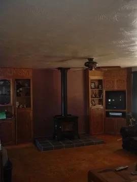

  • [Hearth.com] What's it cost to run cieling fan?
