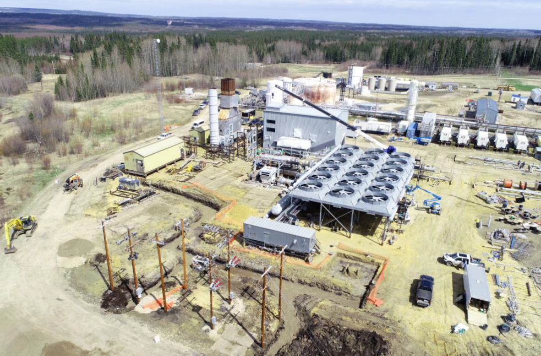

I was part of the construction of the first geothermal power plant in Alberta. It uses an organic rankine cycle turbine (pentane as the working medium) to produce electricity from about 90c produced water. It also uses a a natural gas turbine with waste heat recovery to add more energy to the process. (Not really a true geothermal plant in most people's eyes).
