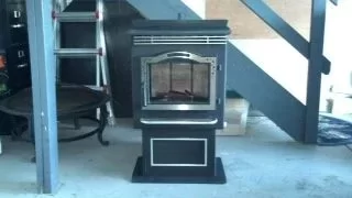

    another stove i have saw used , funny thing is googling the pictures for Harman the only one I found brought me to a thread on this site ow are these units .Apparently works fine $950 picture is it worth a chance for 950 2.5 hrs away? attached they don't know the model other than it's a Harman A.jpg

    It is an Invincible, not sure if RS. They are built like Sherman Tanks and heavy. Looks to be in decent shape but I think you could do better.

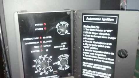

    yup, Invincible, but to be sure, we need to see the controls.......the RS and the Invincible T....the T had an adjustor knob, the RS didnt. They are built like a tank, parts still available. $950 maybe.....but given the age, $950? Offer them $600? I think thats a fair price........

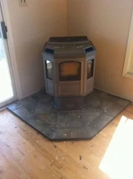

    photo.JPG photo (3).JPG P61A Harman Pellet Stove what is this worth new ? bought in 2010 used 1 season apparently is 2000 too much for it? (with all piping and hearth or whatebver you call it for a pellet stove )

    You are better off with the P-61A than the Invincible. The A is a plus, auto ignite. Give an offer, 1500. Workhorse of a stove and easy to maintain.:cool:

    thanks and Pix above are the unit in question

    Sorry I missed them, looks almost new. Try for 2, nice unit, you will be happy. What have you been using for your primary heat? Electric. oil. gas ???
