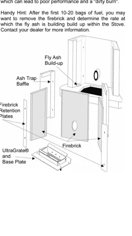

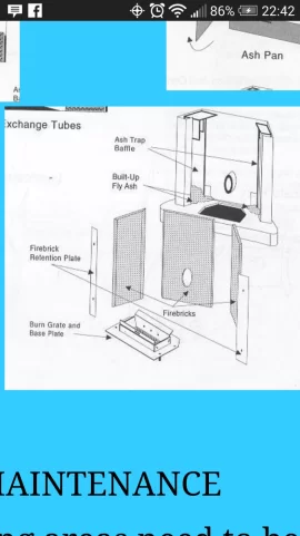

The fire bricks practically fall out. Really simple. There are two different ash trap baffle set ups. The older stoves, like mine, have another panel on each side which needs to be removed too.
[Hearth.com] Whitfield Advantage II Pellets Backing Up Clogging Tube HELP! this is the older version.
And the newer. [Hearth.com] Whitfield Advantage II Pellets Backing Up Clogging Tube HELP!
Thanks I'm pretty sure I have one of the older ones, the grate looks identical and it's manual start. Hopefully tonight I clean it all out and it works! It seems like a great stove even for it's age, time will tell.

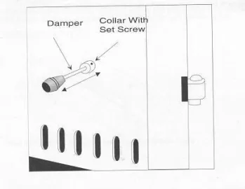

Yea I don't know the middle brick seemed like something was holding it in place the side ones came right out. I didn't see the damper though. When I opened the side were the handle I thought was the damper i seem the exhaust motor that I oiled. Is the damper behind that? Or are you talking about the set screw on the handle. I have it pushed all the way in, when I pulled it all the way out it seemed like it was getting too much air. I went through almost a whole bag of pellets on 1 and the middle of the burn put looks like theres a lump of coal but the pellets don't seem to be backing up just not bruning fast enough. I'm shocked how much heat it puts out though!
Yes, on the damper rod on the left of the stove. Do you see the little collar on the rod itself? I get well, WELL over 24 hrs on setting 1 out of a bag
[Hearth.com] Whitfield Advantage II Pellets Backing Up Clogging Tube HELP! that is it. 2 1/4" from side of unit to inside of collar
