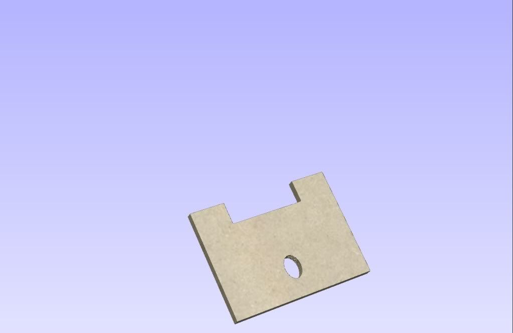

    When you have your own 5'X12' CNC router at home, all things look like they can be made on the CNC.
    So I got in there today and measured the fire brick space.
    This is what I came up with!!!
    Trying to get my hands on some Cerra board to cut it out.
