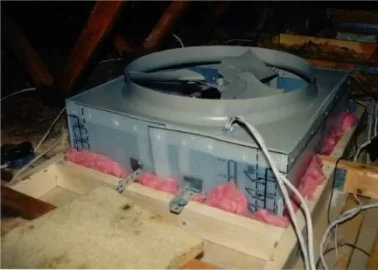

    Other things to consider, Belt drive fans cost more money, but are usually quieter than direct drive fans.
    I have A 30" fan, I was limited to that diameter due to the width of the hallway I have.
    http://www.acehardwareoutlet.com/ProductDetails.aspx?SKU=55288
    The picture isnt quite right, its actually a 4 bladed fan, not a 6 as shown.
    As far as insulation, I build a foam box that goes overtop of it, in the attic, its plenty of insulation.

    I don't want any unnecessary penetrations in my ceilings. And, I am cheap so we have a recycled fan. It is a forward-curved blade centrifugal fan that may have come from a furnace. We run it from late spring through mid fall. It sits on the floor and exhausts at a window that I can close for the summer. Mine has a 1/4 HP electric 115 volt, 5.2 amp motor. I put it on a timer to turn it off after a couple of hours. Somebody gave me this one, but you can pick one up for $25 or free from discarded furnaces.

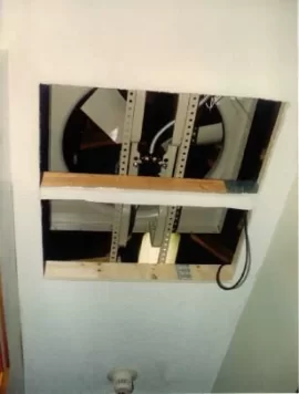

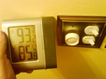

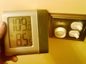

    Hello
    I just did some testing on my whole house fan.
    It is 88 degrees F outside in shade and 94 Degrees F in the Sun and the attic is 109.0 degrees F.
    After running the Fan on High for approx 3 mins the temp in the attic went down to 93.2 Degrees F
    It is 85 Degrees inside!
    How is your fan working these days??

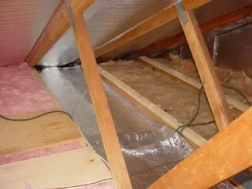

    Hello laynes69
    My house is a walkout split and completely above ground. I added alot of insulation and air sealing in the attic plus the radiant heat shield over the rafters!
    What type is yours? Is the basement below grade?

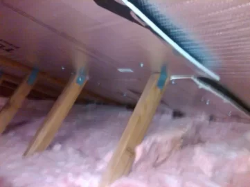

    Our house is an old Victorian around 150+ years old. It does have a basement which is underground. It 2400 sq.ft. with 10' ceilings.
    Some of the walls have urea-formaldehyde which has shrunk some but is around 8" thick. The rest of the walls are fiberglass. We had a blower door test done on the home and rated it as drafty as a barn. There's still more work to be done, but even with the heat outside I measured the ceilings upstairs at 79 which are warmer then the base of the rooms. We put in 14" of cellulose in the attic, which only had 3" last year. So far I'm happy with the results. With the number of windows we have next year we will invest in some insulated drapes. If we left the curtains open the heat gain would climb through the roof. Don, how much insulation do you have in the attic? From the photo of the fan it looks like there is very little. I would think that alot of heat will enter the living space from the attic. I think we installed around an R50.

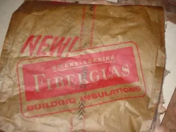

    Hello laynes69
    That pic shows the original New Ownens Corning R7 Fiberglass Building Insulations!!! On the paper back the stamping in big black letters is "ECONOMY" So in 1962 when the house was built they had R7 economy insulation!! LOL
    So I ripped it all out, rolled it up and hauled it all to the dump!!! Then I put down R4 Reflectix foil to air seal all the holes and to provide not only a radiant heat barrier to hold in the winter heat below but the polypropylene cover is also a moisture barrier. So then I added 2x2s to the 2x4 studs to make 2x6s and laid in R19 Faced Fiberglass and then crisscrossed it with R30 unfaced fiberglass for a total of R53 !! That saved 100 gallons of oil or 1 ton of wood pellets!!

    Burying the foil worked fine because it is in the attic floor. That is the only place it works good like that. I know most professional installers put the foil over the insulation in the floor but that is because it is already there. Too much work to take it out. The best way to do it is to put it under the insulation. This way, any radiant heat in the living space below is bounced right back to keep it warm in the winter. Then the insulation keeps the rest of the heat in. I think it is not as efficient to put the foil on top and let the radiant heat travel thru the insulation and then bounce back thru the insulation! That does not make much sense!
    According to the info in the link below, I save 50-60% of the heat loss in the winter time not even counting the insulation!!!
    See >> http://www.greenatticpros.com/content/what-is-a-radiant-barrier
    As far as air sealing, I filled the wire holes with spray foam and then added an extra piece of foil over the interior wood wall top plate. Then rolled out the roll of foil. Then added the R19 fiberglass. So no air escaping!
