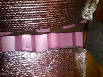

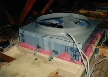

    Yes, I did this quite a while ago so I dug out the pics!
    It works well, just open all the windows a crack.
    However if you want to make the whole house 10 degrees cooler install rafter vents and Home Depot's Reflectix Foil like I did in the last pic :)

    Swapping in and out seems a pain. More importantly, you don't need to cut any joists--see the pics of Don's install. The air will go around. The big return plenum for my central/HP is set up the same way.

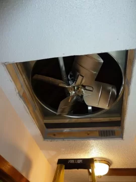

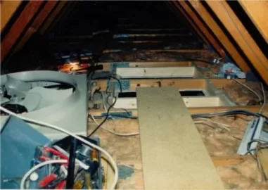

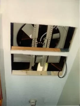

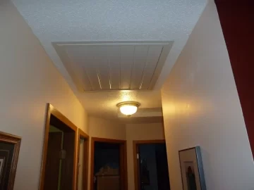

    I didnt want to cut the joists either. But the louver that I had needed it, so I needed to man up and chop through 2 joists. It wasnt too bad to do.
    I had to box out the joists, put down foam strips and then the fan on top of that.
    Here are pics of my install:
    [​IMG]
    [​IMG]
    [​IMG]
    [​IMG]
    Since these pictures have been taken, I have built the insulation box for wintertime, and cleaned up the insulation and the wire (although you could argue thats the least of the concerns as the rest of the wiring in the house is the black stuff that predated romex.
    Its not pretty, but it runs great and really helps cool the house. And sorry for the above confusion, it does use 1/10th the power. The fan is about 450 watts. The AC is (I forget exactly) about 4000 watts. It still makes for a great heat pump, but cooling is far cheaper with the fan. Of course this depends on what portion of the country you are in. In the north east, its good, although the humidity limits the functionality slightly.
