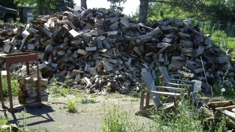

    My religion is something along the lines of letting the wood hang out in the heap for a few years and stack the season's burn under a roof before the snow flies.
