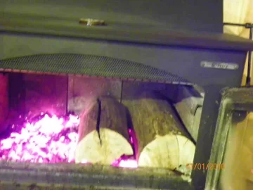

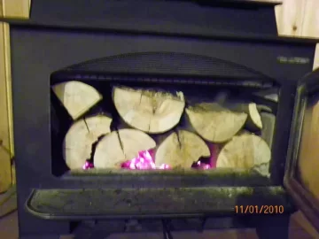

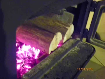

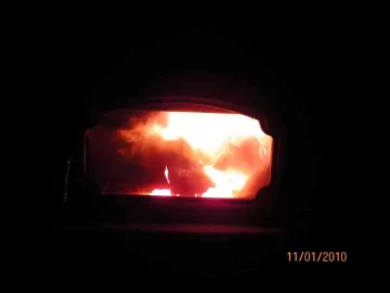

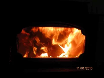

    For those who think I'm crazy bucking our wood 14.75 inches it gives us room from the glass plus it sits on top of the air intake. The pictures are from last night for the overnight burn with the dead standing maple I cut a while back.
    Shut it down about 600 degrees and it went up to 675 and held, in the a.m. the upstairs was 73 and downstairs was still reading 75. Had it 81 downstairs before I called it a night, the wife did a great job burning yesterday.

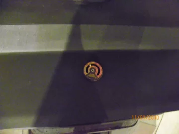

    Picture 1798 is the stove top temp (just under 400) when I did the reload.

    I never thought of loading that way. I like it. I might start cutting smaller

    Zap - we cannot see the file name picture numbers that you refer too...just an FYI.

    if you hover your mouse over the picture it shows the file name. it's the last picture, btw.
