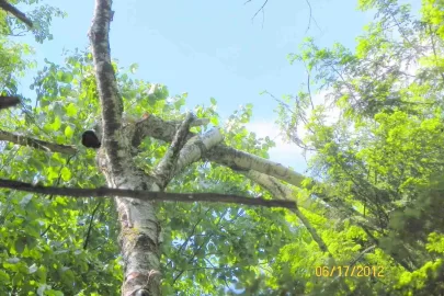

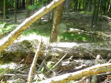

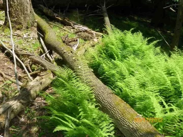

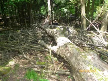

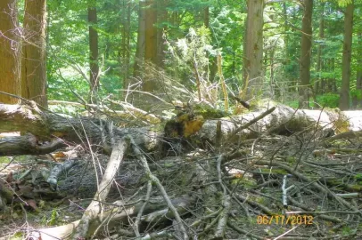

    We have a good size maple down but the widowmaker is still up top, part of the birch broke off. We still have a small ash down in the same area but much safer.

    Forgive me if I am missing the obvious Zap, but what makes it a widowmaker? Can it not be just chained & yanked to the ground?
    *Edit* But the rest on the ground looks good. Mmm, I love maple :)

    Realstone, I'm zoomed in 24 times on the camera, that is way up there so I can't get a cable or rope around it. I think I have two options, wait for mother nature or try felling another tree into the widowmaker.

    Sling shot with a bean bag & throw line to pull your bull rope up there Zap. Nothin to it.:) A C

    Then that's one tall birch!
    Crossbow with 600lb test line should do the trick ;)

    Eeek. That birch looks wicked ugly. D9 Cat with ROPs???

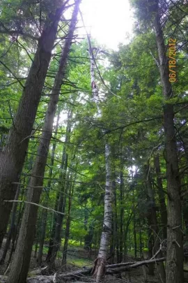

    I was up top today so I took a picture of the Birch.

    Yep, slingshot for sure, my arm ain't that good anymore. A C:eek:

    That is a nice tall birch Zap. Is there room to fell it cleanly? Pic #1 seems to show an open area to the left of the birch, and perhaps a tendency to fall that way.

    I think so Realstone but my worry is that widowmaker coming down and back at me. Next time I'm in that area again I'll take a better look at the Hemlock the widowmaker is hung up in.

    Realstone, I mean no offense, but I wouldn't go anywhere near that tree with a saw till that widow maker was pancake flat on the ground. Stuff like that falls when it falls, & if you wiggle that trunk putting a face cut, back cut, or just pure bad timing, it nails you in the head. A helmet may save your brain, but that sucker would compress your spine, or break other bones from that height. Felling snags, or leaners, is best done with ropes & rigging. A throw line, bull rope, & a redirect block & tackle setup is far cheaper than the E R visit/time off work or worse. Just my .02 cents worth, take it for what you will. A C

    I would be wise to heed such advice as I am back in the scrounging/cutting game after a 20 year hiatus. So I guess it also couldn't be winched out from the bottom very simply either?

    The problem with that is the stump prolly wouldn't tip without cutting the base. That's why I'll always try to remove the snag or hanger first.
