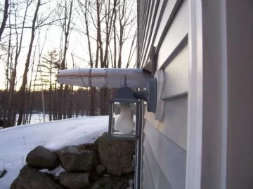

My stove was installed by the dealer who used 3" ICC Excel pipe and a Harman wall thimble with OAK.
I have had to tape the seams due to a little leaking at startup. I have also had soot formed using softwood pellets on any feed rate above 3.5 (I know that the manual says to leave it at 4 and forget it). My ash is a darker color, almost black, and not grey.
I have read the following values are used to figure out EVL: 90 deg = 5, 1 ft horiz = 1, 1 ft vert = .5.
If the above is correct, ny EVL is 16.05 with the following: 2 90's, 65" rise and 41" horizontal.
I can do the changeover myself as I am now much more comfortable in the workings of a pellet stove. The question is this, is it worth the money to change? Am I losing more than the obvious listed above? I am leaning towards doing this over the summer.
I could always sell the 3" pipe to help the cost.
Any insight either way is appreciated.
Thanks
Geno

usually, you should be going to 4" pipe with an EVL over 15' or so.......so, youre marginal there.....if you change over, you will no longer be able to use the wall thimble, since they are only 3", so you'll need a different thimble (haman doesnt make a 4" intake thimble), as well as new pipe......
I see you have a venturi end cap on that thing.....my first suggestion, before you go and buy new pipe, would be to yank that thing off of there and run for a bit without it.....see if it changes at all for you. If you do this, make sure you cover the pipe when you get done burning, so critters dont make a home in the pipe!
my 2 cents!
I will try removing the venturi end cap. I think that I have already tried removing the OAK pipe.

From your pics, I can almost guarantee my basement install is way more complex than yours. So if you are having to tape the seams I think there is something wrong. Excel's 1/2" removable orange gaskets, laser welded seams virtually guarantee no leaks. Even Excel will tell you tape is not needed.

Why do you need OAK on such a short pipe?, just a 3" plain exhaust would do fine, the room the stove is in with those unfinished windows looks like you'll have plenty of air to feed the stove.....talk about OVERKILL!! and a big waste of $$$$$
Sorry Pellet-King does not approve of an OAK, but I prefer to use one. Not a big added cost on this 16.05 EVL set up. Not huge length, but not short either.
