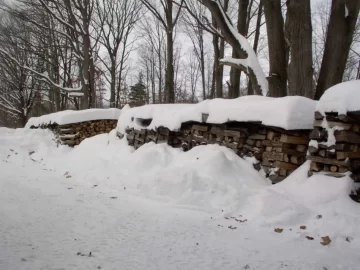

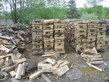

    Here is how we do it. Cut during winter. Split after snow melt. Stack immediately after splitting. Do not cover the wood at all that first summer and fall. The first picture was taken while I was stacking last spring. Those stacks are still not covered and I'll probably cover them in December.
    The second and third pictures are some I experimented with. We use mostly old galvanized roofing as you see in the third picture. In the second picture we used some rubber roofing. We still like galvanized the best. The 4th picture was taken on Christmas Day a few years ago. Those were all covered with galvanized roofing. We have used tarps in the past but don't like them. Something solid works much better and is easier to get the wood when it is snow covered.

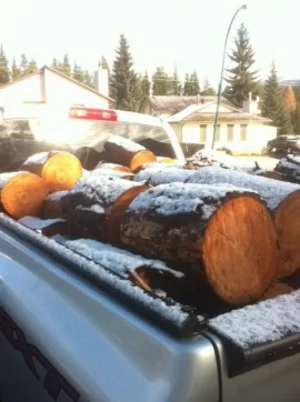

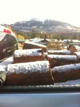

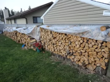

    I do have a single attached garage which makes it easy for moving wood to the stove so we keep a weeks worth in there. I dont think I would have room to store large amounts in it since we use it for other things. I picked up close to a 1/2 cord of Larch the other day from the forest in the picture I took today from my back yard. Nice and close! We were in the yard preping for winter and unloaded it and split a bunch. Half of the Larch is quite wet (next years burn) but I was surprised that the other half when split was only 21.5% moisture so I will be able to burn that earlier than expected. Im still thinking of covering it completely up since the pine is so dry and airing it out during those cold clear days.
    Sean
    Gasifier and albert1029 like this.

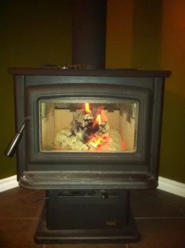

    I spent quite a lot of time researching stoves and found myself reading what was posted here. There sure is lots to choose from. I wanted a simple non cat stove that would burn clean. Heres a photo of my fire at the moment, not a ripping fire but its nice and warm in here. When I get it firing with a good reburn I will post a picture. I find I spend lots of time staring at the reburn. Its amazing how the fire moves around in the fire box, very pretty! Oct 21 fire.JPG

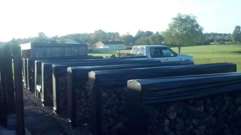

    I enclosed a portion of my back porch today. I'm gonna store about a cord in here. I have my stacks top covered and I have a small shed. But this will keep a fair amount of wood under complete cover (soffit are open and ends are open so it breathes).
    Top cover is fine. But I like to have it inside (or under full cover) for a week or so. How much wood can you store inside at a time?
    2012-10-21_10-16-55_666.jpg 2012-10-21_13-45-32_785.jpg 2012-10-21_18-52-29_175.jpg 2012-10-09_17-51-51_800.jpg
    Gasifier, albert1029 and ScotO like this.

    Looks like you have it well thought out. I like the idea of the porch for storage! I guess I could put a cord in the garage but then I would have to store the snow blower outside! I have close to half a cord up against the house which is somewhat protected by the roof overhang. Our yard is not the biggest so even a wood shed might be hard to build. To answer your question I can store comfortably a row that is 6' long by 5' high. I guess I could double or triple that up without to much fuss.

    No. Just 4 mil black plasctic. Pulled tight and slap stapled.
    6' x 5' is a good amount to keep indoors. IMO.
    Plenty enough time to dry any surface moisture.

    A couple of extra hands to pull it, some small wooden strips (1.5" wide x 4' long x 1/8" thick - picture a 4 ft long paint stirring stick)), and a 1" brad stapler.
    I have seen people ise slap staplers and strips of cardboard instead. Anything so its not just the staples holding the plastic.
    I wrapped the plastic around the frame and secured it to the back side with the strips going all the way around. Then a couple strips on the front, for good measure. They were built to be removable and reusable. Each section (except the front door section) is removable with 6 - 3" screws. The top is installed in a box/channel, so it couldn't move.
    Hope this helps.
